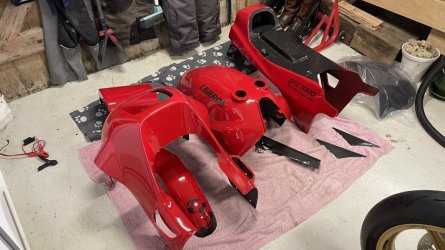

I haven’t touched the frame or the engine internals, but here is a few facts and figures:
The Marvic wheels weighed in at 3,5 kg front and 4,7 kg rear at arrival
The original Oscam front with discs, tube and tyre 15,7 kg and rear with disc, sprocket, tube and tyre 18,9 kg giving a total of 34,6 kg
Marvic magnesium’s complete 11,3 front and 13,6 rear for a total of 24,9 kg giving a total weight saving of 9,7 kg
OEM tank 7.0 kg- Carbon tank before sealing and paint 2.390 kg Saving 4,610m kg
OEM fairing 2,610 kg- carbon fairing 755 g Saving 1,855 kg
OEM seat 3,8 kg- carbon seat 1,550 kg Saving 2,250 kg
OEM front fender including “brace”, bolts and brackets 872 g- carbon fender incl Redax brace 613 g Saving 259 g
Shorai carbon battery saving just over 8 kg compared to the OEM item
These “big savers” total at 26,674 kg- equivalent to just over 50% of the result so far.

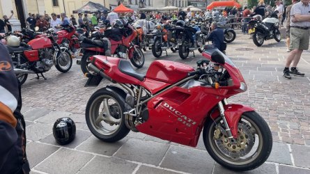

A Ducati at a Laverda meet😔
But the WEIGHT of that exhaust

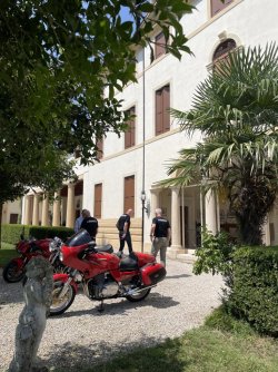

A nice visit at Pieros place
Going home from Breganze I went to my favorite area in the Dolomites and climbed 6 passes above 2000 m
