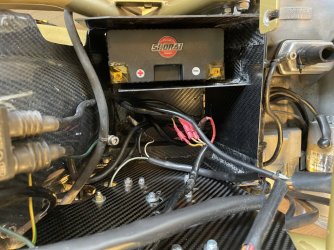

Battery box

You spend so much effort, time and money and use the crappiest electrical connectors known to mankind?? :eek:
Positive as always Piet🙃
I started with a mention that about 2% of the work is missing- the majority being electrics. The lousy work was done about 20 years ago.
A professional electrician will make it right. Have a little faith ffs
