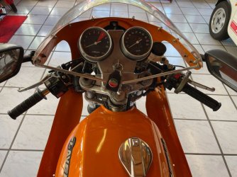

I am an engineer, and think of machines in risks and requirements, so did I procure this bike.
Compression 8.0 Bar and running like shit, blue smoke and black smoke.
It had the original bosch ignition and pickups, ND clocks, bodgy wiring, but the reassurance that all was revised, overhauled and attended to.
Interesting project for me, as I had already owned an original SFC bought from Richard Slater and missed it, a whole different story.
So I set up a project file, assessed risks, costs and feasibility, but in fact really wanted the bike.

Welcome to the club Ernestee0! I think I know what you're talking about and also did kind of comprehensive lists before deciding a purchase. But also I know the point when I stopped doing this approach because I wanted the bloody thing ...
