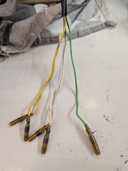

Can I just remove those two unused wires?View attachment 100729

Yes, the yellow cable is splitted in two cables and the white blue as well. One yellow and one white blue you do not need.
But, it is not Italian electrick, the genator is Japanese.
