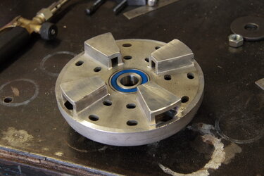

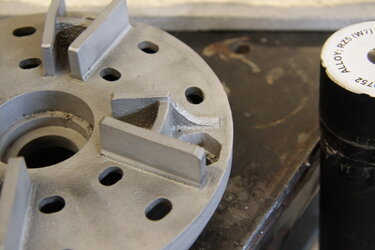

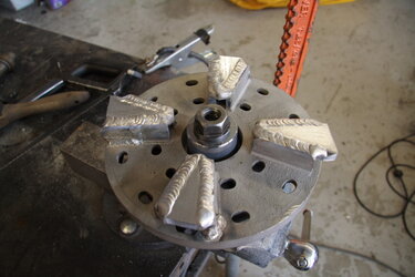

The cracking I experienced had already happened before I bought the bike. A section of the cush drive 'vane' had broken. Pretty clear to see why given the unsupported legs which transmit drive through the cush rubbers. So no problem with the spokes or main body of the casting. Fantastic repair job by Keith Nairn who managed to identify and locate some of the correct material to strengthen the design, and rods to weld it.

Same type of break happened to an alloy aftermarked part I have on the side.
I noticed while disassembling the wheel that the required central washer (between the hub and the cush drive) was too thin and therefore insufficient clearence.
Really a point to check if acquiring an aftermarket hub. Some were modified so as to be able to remove this washer.
