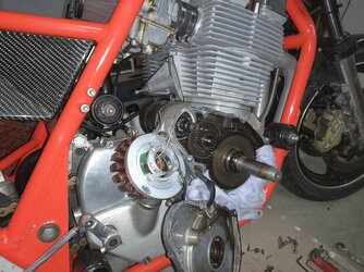

After my last ride I noticed a small amount of oil on my right boot. Upon checking I found some oil under the right ignition/alternator cover. There was also a bent piece of rubber found in the cover which I suspect is from the shaft-seal in front of the sprag-clutch:
Will find out with OCT in the next days. At least it's a good thing that my 3c stayed tight on the last major trips (5,000 km in the last 6 weeks) ...
use a 5mm wide seal Jo
in place of the stock 7mm wide one. it works well and the left hand thread hexagon sleeve nut has greater clearance from its rotating hexagon head.

Thanks again for the tip Clem. I just checked in the garage, the new shaft seal that I'd obtained some time ago from OCT is the 5mm wide version. In addition, the roller bearing should also be renewed, I already have that too.
Today the previously described slight oil loss at the ventilation hole of the generator on the right was examined at OCT. It quickly turned out that the bearing (16006-C3) in the cover between the starter clutch and the alternator/igniter had given up the ghost and damaged the shaft seal as a result:
Debris parts of the oil seal were found in the alternator/ignitor area. A few residues have probably also gotten into the oil sump, so I’ll change the oil again to be on the safe side.
