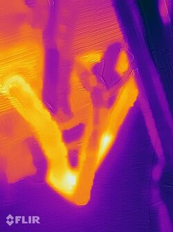

Just a point on this missed earlier.At Roebuck, fancy BP 98 pump. Filled tank and 10L jerry. Rode off pinging like a bastard. I dont know the 1200CR but plus 10. Riding slow flipped the lid and poured in a wynns thing. Worked but not fully. Im guessing events overlapped with the slowly failing contact on the coil to centre spark.I very much doubt that octane booster will clear a fouled plug or make the centre cylinder work harder. I reckon you should fit a new plug or tweak the carby tune.

Yep the ping and the gurgle. First worried the gurgle was blowback through the inlets. I've cooked valves! disgrace! Paranoid shit. Flipped the lid and heard the gurgle coming from the pipes. Stop the bike. get all the luggage off. Start at the sotty plug. Clean it. Test for spark. Zero. Work back. Wggle the coil wires. One feels loose. Pull it. A little arcing on the spade. A little squeeze. Start her up. All good.Well done finding a loose connection to the coil. Intermittent faults are notoriously difficult to track down.
Just guessing here: If your your engine is hot and the ignition isn't firing reliably, you may get a compression ignition of the unburnt mixture on the strokes when the spark misfires. I dunno whether that would sound like pinging though.
