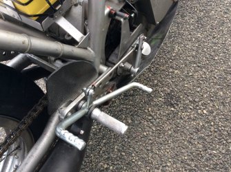

Another opportunity to test the revised gear change layout today at Jurby. I completed 4 sessions of approx 20 minutes and by the last session the track was getting pretty dry so I was pushing a bit harder so a clean gear change was needed. The switch to the heel and toe change is definitely a move in the right direction, with generally a reliable gear change at last. The odd fluffed change, mostly on the up shift, so I probably will need to modify the up shift lever a little 8F70761E-73D0-4598-B0BF-ABA4B9BB50BA.jpeg56A73248-AC49-4141-B013-F6BFADFDBFC1.jpegbit so I’m not having to move my foot around quite so much, but otherwise I’m now a lot happier than before.

With all the rowing about I have been doing, plus multiple adjustments just to find a reliable one-click gear change, maybe I need this as well. I am hearty sick of the need to use the side of my boot for a tiny upward movement before downshifts. All it would need is a replacement toe and heel lever; finding the spare parts might be tricky, though. When is Wolfgang back from Europe?
Vince, you need a cutaway outer selector cover so you can see exactly why the hook is not engaging for the next gear after you shift. There's a simple mechanical reason for the issue - it's either adjustment, or you need a new part or two.
New parts went in during the last adjustment after I found a cracked spigot in the case cover from a tipover a few years ago. I got a second-hand inner cover and C-hook from Red. I get 3rd, 4th, and 5th fine; it's usually blocked going down to 1st, maybe 30% of the time. I am also feeling binding in the links. That happens 2 or 3 times a year, so that needs grease. I have had great changes for years, but once I break a spring, I chase that adjustment for ages till it's set. BTW I just warmed to the idea of a heel toes shifter, I just reasied it mimics the concept of a race pattern shifter instead of the limited space for your boot leaned over for upshifts you heel allows upsffts without your boot draging on the road. Less physical dexterity as well in long races. Those SFC designers knew their stuff.
I tend to ride with the ball of my foot on the peg to avoid my boot dragging in corners. This means my heel is hovering around where the up shift lever is positioned. I was mostly able to just dip my heel and select the next gear without too much of an issue. However, it would occasionally select a false neutral, which is why I said the lever position needs a little fine tuning. Frequently it would change up with very little pressure on the lever but it would be better if it did it every time!
I mostly ride with the pegs on the arch of my foot. I think it's a dirt bike thing: standing on the pegs, weight-bearing. I tried standing on the balls of my feet, and it just doesn't feel right for me. I mainly have downshift issues into 1st so a heel change won't be groundbreaking. But I do have a bent rearset gear lever, and if I can get a replacement off Wolfgang, I can use the new one and maybe modify the slightly bent one into a heel lever. I might be able to fit both onto the pivot on the rearset peg, one facing forward and one towards the rear, and use the height-adjustable pins to connect them together and not even need any welding. I won't know till I try
