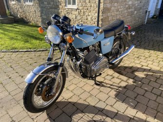

This bloody bike. 1976 3CE

Been very wet in the UK and folk have lost their lives and had their homes and businesses flooded, but today was nice and bright but windy, a good day for a small test ride. Away we went and stalled it outside the pub at the first road junction but a fiddle with the choke got it going and it pulled nicely enough. On to the duel carriageway past Silverstone circuit and it didn’t want to pull higher revs - at what I cannot tell as Venhill cables are on back order and Peder’s rev counter flange is yet to arrive. Although the carbs have been apart and cleaned numerous times there could be some playing to do with needle heights and jets, but there was a pop bang so maybe still problems with the pickups.
Back in my drive and there’s oil on my right boot which I think is from the right hand end crank seal..
The spring on the rear brake light switch has over stretched and the neutral light won’t go out. Sump switch or wiring?

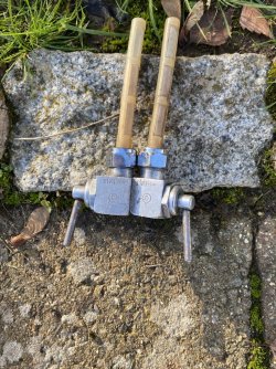

There has developed a bubble in the new paint on the top of the tank so digging around shows a small hole but I’m going to line it with POR15. To do that I emptied out the tank and took the taps off. I thought the flow from the taps could have been stronger so maybe that could be related to it not reving out.

Robin, reference your comment about flow from the fuel taps - when I rebuilt my '77 Jota 10+ years ago, I bought a pair of cube taps from a seller in Italy.
On the first few rides after the rebuild, the bike ran well, but when I began to open it up a bit it would pop and bang and not go any faster. I traced this back to the fact that the cube taps were too small and had insufficient flow - two new taps fitted, away we go - wide open throttle - wahay, it went like the bloody clappers!!
Could this be your problem??
I think I've got a spare pair of BAP fuel taps that you're welcome to borrow, if you don't have any spares - at least that'll eliminate or solve the problem.

Alan that could well be it. I see a pair of taps is £75.00.
Here is a picture of mine. It says R101/1 sin on both
